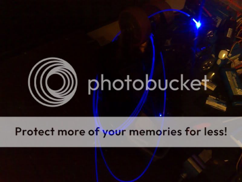

Here is some pictures of my recently arrived 445nm laser diode !
I only have a driver that feed the diode of 500mA and the diode can handle 1.1A.
So the power I have now is less than half, maybe 300-400mW , with 1A I will get 1W with blue light Smile
some pictures:
The unjacked Fiber-optic get a nice blue colour when I put the diode at one end Smile
The output seems also nice..
I will try to do some test of this in my nozzle when I got time.

I have also talked about safety with other ppl, and take in concern that I will use unfocused fiber, there should not be any real dangerous of looking into the light from a distance at 30-50Cm (will not be possible to get closer..
and where I planning to mount my nozzles, there will be impossible to get the light in your face anyway.
But again, this is only some ideas and testing..
If you planning to work on lasers, BE SURE YOU KNOW THE SAFETY FIRST !!!!
I have been working with lasers the last 10-15 years, and know about the dangerous involved.

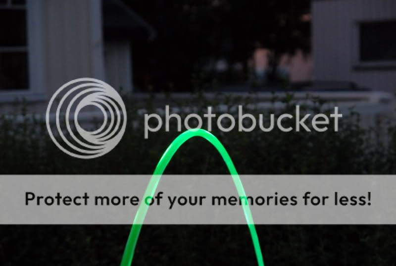

Hi
I have not done any test with a 3Watt led.
But I have 2x 3W red led I can do a test tomorrow and compare to one red laser!
Some video and pictures :
The nozzle was working P E R F E C T !!! on the first try !!!! :-)
I did start building my nozzle from scratch yesterday, and finished 1hour ago.
There is only 1 filter in bottom, filled up with straws, and that is all :-)
Ah.. yes and the fiber optic mount inside.
I will upload more pictures later (have no time atm, so enjoy the video)
Red, green, and blue laser:
Blue only:
