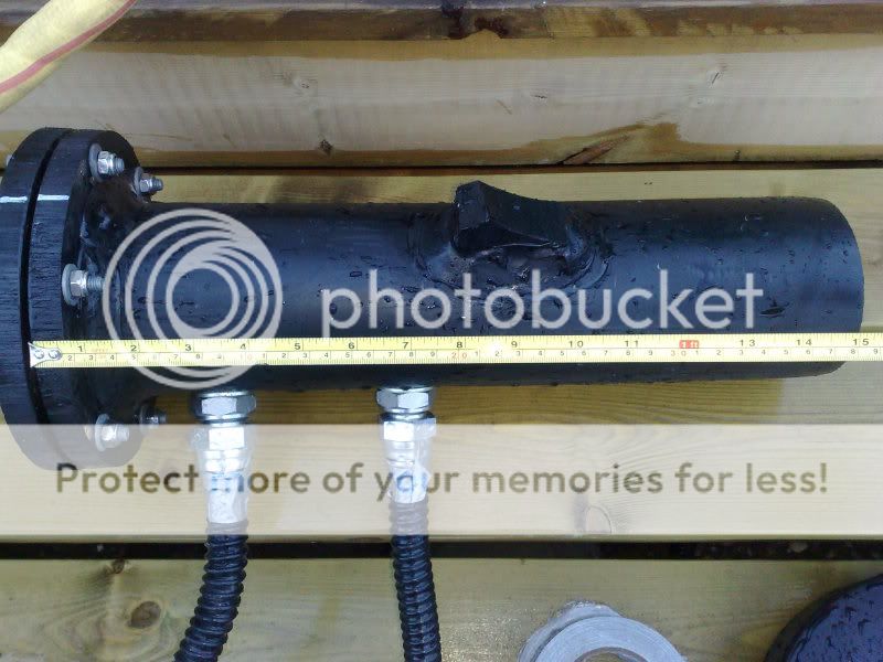

Post  smiley7661 on Mon Dec 27, 2010 1:10 pm
I am just starting my project and will be attempting to make 2 Laminars off of one pump. I have seen discussions of the Low pass filter, and seen a few pictures, but I dont know exactly the construction methods. It seems that they are 3" Pipe with two openings, one in and one out. What are the measurements of these (Total 3" length, distance from bottom to 2nd opening) and is the water fed in the bottom or middle one?

Post  liteglow on Mon Dec 27, 2010 3:23 pm
smiley7661 wrote:I am just starting my project and will be attempting to make 2 Laminars off of one pump. I have seen discussions of the Low pass filter, and seen a few pictures, but I dont know exactly the construction methods. It seems that they are 3" Pipe with two openings, one in and one out. What are the measurements of these (Total 3" length, distance from bottom to 2nd opening) and is the water fed in the bottom or middle one?
There is no actual size you need to have on the low-pass filter !
Actually I did remove mine because there was no need for any filter Wink
But the low pass filter is only a "buffer" of air on the top that remove jitter\bubbles from your pump.
If you have a tank (let`s say for the theory) it`s 10" high and 3" in diameter.
You have the water input on the bottom or on the side.
Then you place the water output almost half the way up (3-4" up from bottom) !
Then the part from the water output and up to the top only be air that will move up\down depending on how powerful your pump system is.
So the size of the nozzle depends on the pressure of your water-flow, size of nozzle and pumps Smile
If there was anything here you did not understand, just ask :-)
Here is a picture of my low-pass filter :
Cheers
Filip
