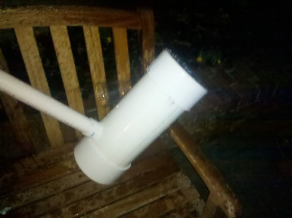

Hi... So glad I've found this site... Spent the last few weeks lurking here, youtube, and google to get the basics of a diy laminar nozzle...
So far I can only project a laminar stream about 5ft - the water pressure will go about 35ft.

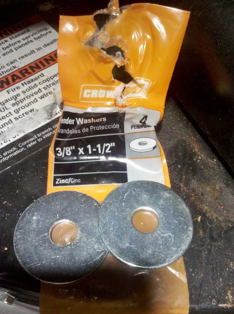

6" build, foam base, screen, full-size straws, screen, 3" gap and flat top and using a washer for a tip on the inside.
How can I get more than a 5ft stream - anything larger starts to break-up at the end and get worse the larger I go.... Kinda cool how Sants'a nose and eyes look in the stream.... This is using my water hose as a supply
Your thoughts?

That is great, the washers you use is a clever way to have the output.
I did also use that for my first tests !
But the best if you can find someone with a lathe to build you a razor sharp brass ring and replace the washer.
You will notice big difference in the sharper and more clear output of the water Smile

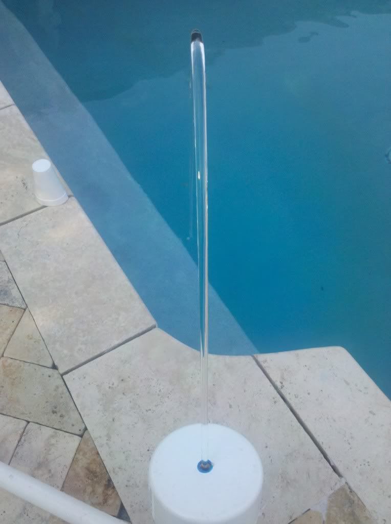

So....... I got em' and one thing or another has gotten in the way.... I've used Foam, straws, scrtch-bight, pond filter, and mesh screens.... I cannot get a laminar stream greater than 5' or 6'. As you can see in this pic, I'm using a .5" nozzle from John and the stream vanishes on impact to the water, but I can get much bigger.... I need to double if not triple this height and distance. Do I need to give up on the 6" tube?

Post  John on Wed May 18, 2011 8:51 pm
Yeah, I think it's time to upgrade. It think you'll be able to get double that with an 8" pipe, but triple might be pushing the limits.

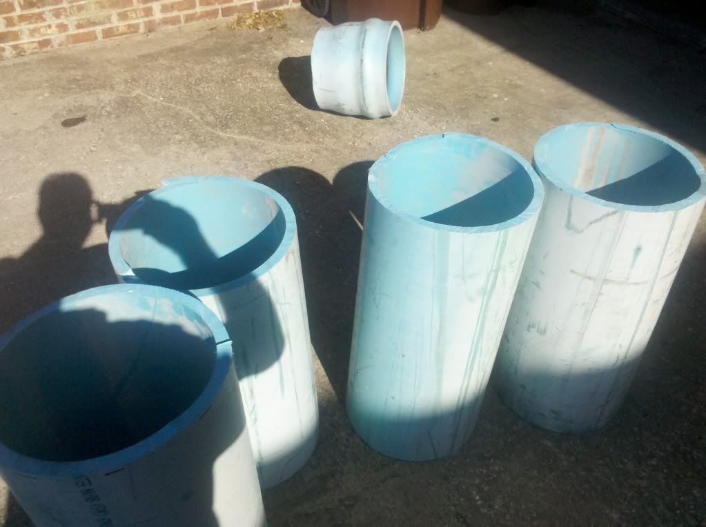

well..... I may have gotten carried away.... The guy had 6,8,10,12-36" tube.... He charged me $2 per foot. I chop cut it and drove off with 8' of 12" pipe... I'm going to mock up (1) and post my trial and error.... These are about 27"X12" ID
